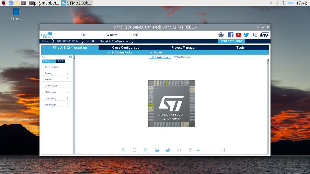

You can run STM32CubeMX and STM32Cubeprogrammer on raspberry pi; probably on any arm64 linux.
STM32CubeMX
Check java is installed:
pi@raspberrypi:~ $ java --version
openjdk 11.0.15 2022-04-19
OpenJDK Runtime Environment (build 11.0.15+10-post-Debian-1deb11u1)
OpenJDK 64-Bit Server VM (build 11.0.15+10-post-Debian-1deb11u1, mixed mode)
Download stm32cubemx for linux:
pi@raspberrypi:~ $ ls -l en.stm32cubemx-lin_v6-5-0.zip
-rw-r--r-- 1 root root 414664915 May 16 17:35 en.stm32cubemx-lin_v6-5-0.zip
Unzip and install:
pi@raspberrypi:~ $ mkdir zzz
pi@raspberrypi:~ $ cd zzz/
pi@raspberrypi:~/zzz $ unzip -q ../en.stm32cubemx-lin_v6-5-0.zip
pi@raspberrypi:~/zzz $ ls
jre Readme.html SetupSTM32CubeMX-6.5.0
pi@raspberrypi:~/zzz $ java -jar ./SetupSTM32CubeMX-6.5.0
Run STM32CubeMX from the installation directory:
pi@raspberrypi:~/zzz $ cd ~/STM32CubeMX/
pi@raspberrypi:~/STM32CubeMX $ ls
db jre plugins third_parties_plugins utilities
help olddb STM32CubeMX Uninstaller
pi@raspberrypi:~/STM32CubeMX $ java -jar ./STM32CubeMX
