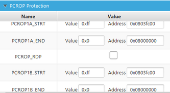

PCROP protection has the following values:

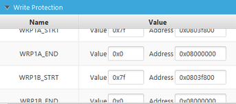

Write Protection has the following values:

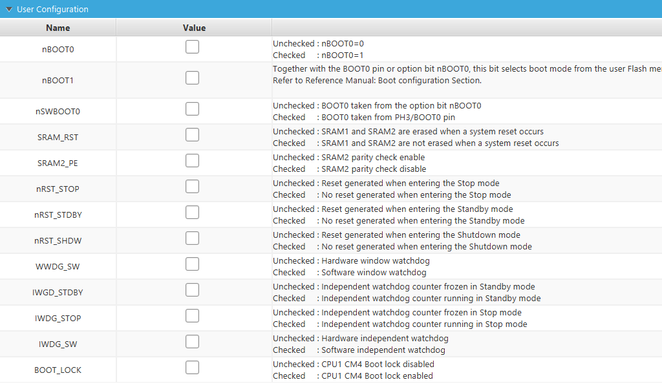

And to make it complete, this is my bodged user configuration of the option bytes.
