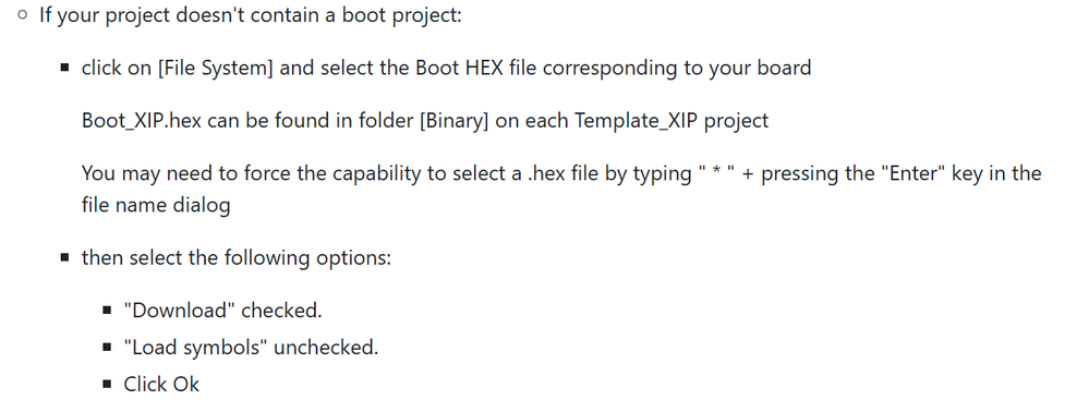

 where can i get the Boot HEX file? can you tell me the Location of the hex file?
KDJEM.1
Hello @Berlin-raj123 ;
You can find the Boot_XIP.hex file under the STM32CubeH7RS path "STM32Cube\Repository\STM32Cube_FW_H7RS_V1.2.0\Projects\STM32H7S78-DK\Templates\Template_XIP\Binary"
Thank you.
