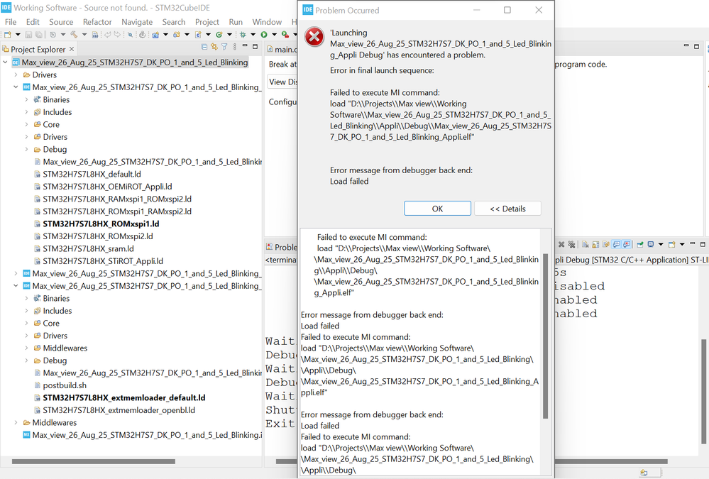

I am working with the STM32H7S78-DK board and I want to toggle the LEDs LD1 (PO1) and LD2 (PO5).
I followed the instructions from this GitHub resource:
https://github.com/ST-TOMAS-Workshop/stm32h7s_workshop/blob/main/1_external_memory/handson/1_extmem_intro.md
and this YouTube video:
https://www.youtube.com/watch?v=sPiFBzvCWfI&t=945s
However, when I try to flash my program into the development board, I get this error:
I am not able to program the board because of this.
:right_arrow: Can anyone guide me on how to solve this flashing issue?
:right_arrow: Do I need to configure something specific in STM32CubeIDE or CubeProgrammer for STM32H7S78-DK?

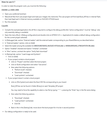

KDJEM.1
Hello @Berlin-raj123 ;
You can find the Boot_XIP.hex file under the STM32CubeH7RS path "STM32Cube\Repository\STM32Cube_FW_H7RS_V1.2.0\Projects\STM32H7S78-DK\Templates\Template_XIP\Binary"
Thank you.
Kaouthar

KDJEM.1
Which STM32CubeIDE version are you using? Could you please with the latest toolchain version.
I recommend you referring STM32CubeIDE: How to debug an STM32H7Rx/Sx project without flashing boot every time. - STMicroelectronics Community  article and follow the steps indicated.
Are you experiencing the same issue with STM32CubeH7RS cube firmware Examples?
I hope this help you.

version : STM32CubeIDE 1.17.0
No, actually I used the GPIO Toggle example. It loaded properly, but the LED is not blinking on my STM32H7S78-DK.
@KDJEM.1I followed your resource, but I am still facing the error 'Failed to execute MI command.' What can I do? How can I flash my code to external flash memory? I will send you the LED [PO1] toggle code. Can you check the IOC?
Can you please Support me

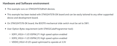

For the GPIO_IOToggle example issue, I recommend you to refer to the readme file and check the hardware and software environment and also how to use it? sections
Please let me if the example issue solved or not?

@KDJEM.1  Thank you for your reply.. i was using your above instruction, but still i am facing that same issue.
and i tried below versions
cube ide version 1.17.0 & 1.19.0
cube mx version 6.15.0
cube programmer 2.18.0
