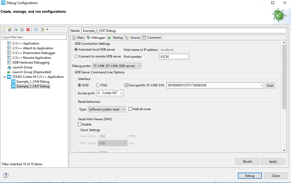

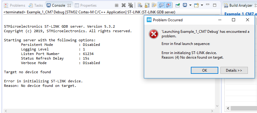

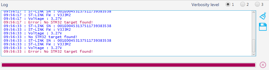

I can't program and debug with the STM32H747 Discovery kit. I tried Stm32cubeProgrammer and STM32CubeIDE for this. Below are the errors I have received in both.
Debug configuration screen is below;
STLink Serial number appears, but I can't understand why it can't program it?

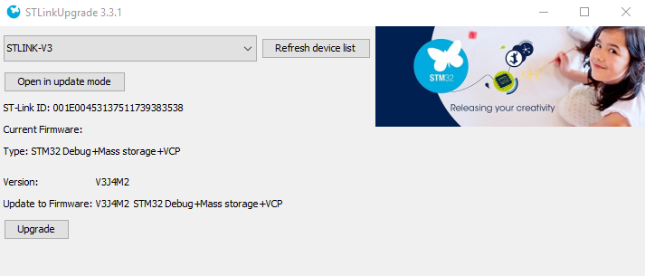

Hello @Markus GIRDLAND
The result has not changed, although I have implemented the document step by step. I updated to see if there is a problem with the STLINK version. But the result did not change again.
Version information is below;

Hello @Markus GIRDLAND (ST Employee)
In addition 2 of 4 discovery boards are in this case.
