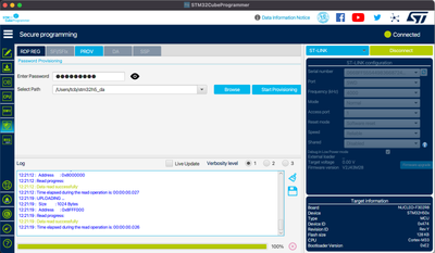

First, I'll describe what happens in the GUI. I successfully connect to my target, enter the Secure Programming section, and click the PROV tab. I enter a password, choose an existing directory for the password file to be saved, and click Start Provisioning. Here is a screenshot just before I click the button.
When I click Start Provisioning, the window instantly closes; no error dialog is shown.
