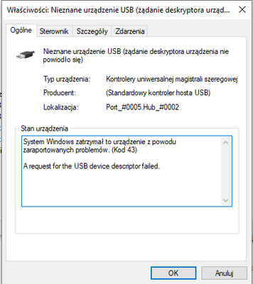

       First of all im not abble to connect via DFU usb, device isnt recognize i try reinstal stmCubeProgrammer, didnt change anything. Then try install drivers too device manualy, windows claims that best drivers are installed.

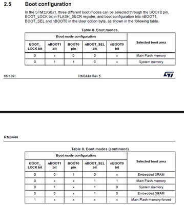

The STM32G0x1 series has the BOOT0 Pin disabled by default. To use the "legacy" Boot mode via BOOT0 You have to write thenBOOT_SEL Bit to 0. see Capter 2.5 of RM0444:
The BOOT via UART is working the first time only because the flash is empty.

I don't think that the STM32G071 series has an USB controller, if You need USB (FS) you need to switch to the STM32G0B1 or STM32G0C1.
