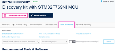

Hello @JakeW ,
The binary demonstration files for STM32F769I-DISCO are available under Tools & Software/Compiled demos section.
Sara.
