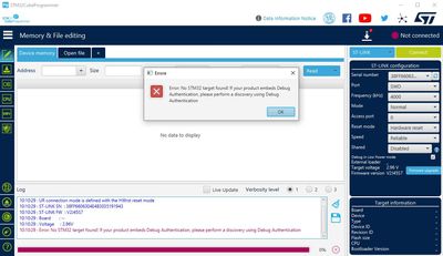

I am using STM32CubeProgrammer 2.4 version on a PC (let me call it PC_1, Windows 11 Enterprise OS) for programming a board (a customized seld-developped one) where there is also the STM32CubeIDE SW for FW development. You see below the program screen

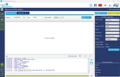

On a second PC (let me call it PC_2, Windows 10 Enterprise OS) I installed STM32CubeProgrammer 2.16 version:
in this case I am not able to connect (for programming) the same board (with the same ST-LINK V2 device and cable) I am able to program on PC_1 with STM32CubeProgrammerr 2.4. You see below the PC screen:
NO STM32 target is found!!
