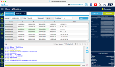

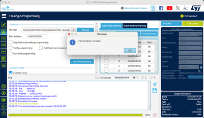

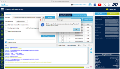

Using the J-Link, I can read the flash and erase sectors, but the program immediately crashes when I try to program a file. It works fine using the ST-LINK.
ST-LINK programming:
J-Link reading and erasing:

ST-LINK
./STM32_Programmer_CLI -c port=SWD mode=UR reset=HWrst freq=4000 ap=1 -el ExternalLoader/MX25LM51245G_STM32H573I-DK-RevB.stldr -d demo.bin 0x90000000
STM32CubeProgrammer v2.17.0
ST-LINK SN : 0051002D3532511731333430
ST-LINK FW : V3J11M3
Board : STM32H573I-DK
Voltage : 3.29V
SWD freq : 3300 KHz
Connect mode: Under Reset
Reset mode : Hardware reset
Device ID : 0x484
Revision ID : --
Device name : STM32H56x/573
Flash size : 2 MBytes
Device type : MCU
Device CPU : Cortex-M33
BL Version : 0xE4
SFSP Version: v2.5.0
Debug in Low Power mode enabled
Memory Programming ...
Opening and parsing file: demo.bin
File : demo.bin
Address : 0x90000000
Erasing memory corresponding to segment 0:
Erasing external memory sector 0
Download in Progress:
[==================================================] 100%
File download complete
Time elapsed during download operation: 00:00:00.430
Erase sector(s) ...
Flash erase...
Init flashloader...
Loader sector erase...
Init flashloader...
Init flashloader...
Existing specified sectors are erased successfully
Protected sectors are not erasedThe verbosity is really lacking in comparison
