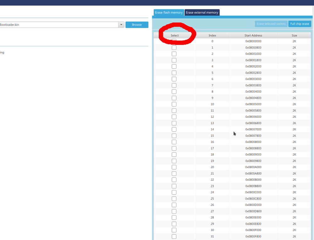

I would recommend to add a select all checkbox/context menu to the page selector of the Erase flash memory table view:
I have a 2 sector wide EEPROM emulated area at the end of the flash what I would like to preserve during the erase operation, and to do so I need click all the 30 items. If a select all feature would be implemented I would only need to select all and untick the last two.

2019-10-16 1:10 AM
The version 2.2.0 of STM32CubeProgrammer is on the web, and it implements this request.
Please check it.
-Amel
2019-10-21 1:42 AM
Thanks, I verified it with a Nucleo-G070, works great.
