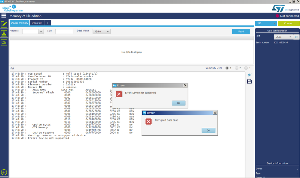

I'd like to use STM32CubeProg with Nucleo-F767 via USB, but CubeProg fails to connect with 'Corrupted Data base' error. I've tried both Windows and MacOS versions, results same error.
I guess STM_Prog_DB.xml is the 'data base' file. How can I fix this DB file?

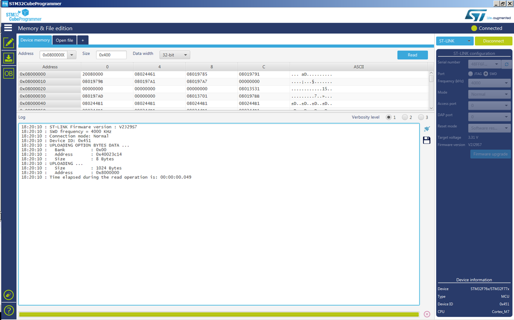

I have the same issue while trying to use USB DFU on a board with STM32F779 NIH6 78A4U VQ Z:
I do connect correctly with STLink connection:
Does the issue come from my STM32 code or from the CubeProgrammer utility? What is that ''Data base'' is '' Corrupted''?

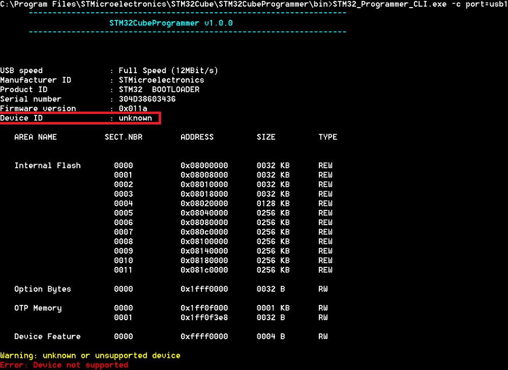

I also give a try with the command line utility, without success : (see capture below)
I think that the ''corrupted data base'' message that we get on CubeProgrammer GUI is due to the ''Device ID Unknown'' where I could get '' DeviceID 0x451''
What is really puzzling is that Serial Number and firmware version is correctly read... Same behavior on the 10 boards that we produce.
2018-02-26 7:40 AM
This issue is already confirmed along to our development team and will be fixed in the coming release.
Best Regards,
Imen
