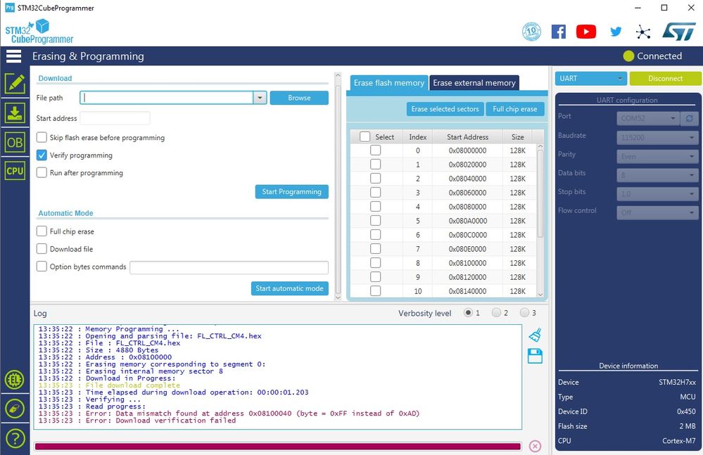

STM32CubeProgrammer gives me an error when I try to program M4 using embedded bootloader. I have no problem programming M7 similarly.
Error:
13:35:23 : Error: Data mismatch found at address 0x08100040 (byte = 0xFF instead of 0xAD)
13:35:23 : Error: Download verification failed

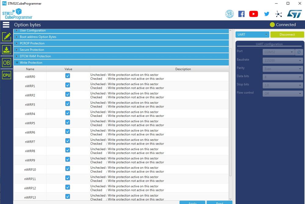

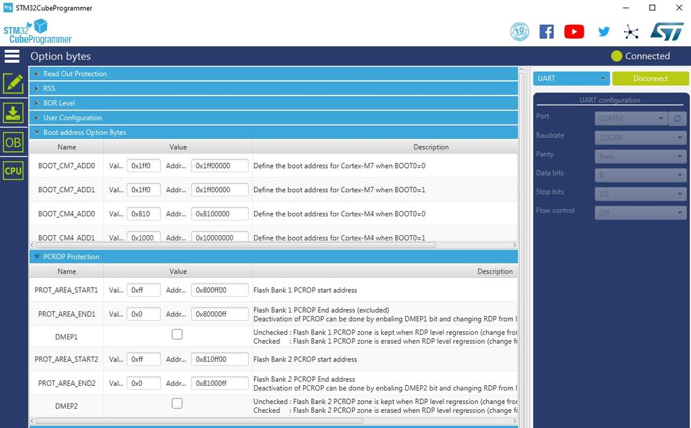

I follow the steps below to access embedded bootloader:
1- Program option bytes on application code(M7) - ( I’m just update BOOT_CM7_ADD0 = 0x1FF0 )
2- Power Off -> Power On
3- Connect the embbeded bootlaoder (After push the Reset Push-Button(B1) Why?? )

13:35:22 : Memory Programming ...
13:35:22 : Opening and parsing file: FL_CTRL_CM4.hex
13:35:22 : File : FL_CTRL_CM4.hex
13:35:22 : Size : 4880 Bytes
13:35:22 : Address : 0x08100000
13:35:22 : Erasing memory corresponding to segment 0:
13:35:22 : Erasing internal memory sector 8
13:35:22 : Download in Progress:
13:35:23 : File download complete
13:35:23 : Time elapsed during download operation: 00:00:01.203
13:35:23 : Verifying ...
13:35:23 : Read progress:
