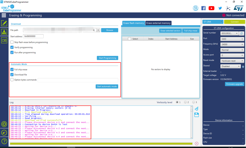

When the first one download complete, disconnect it.
The programmer will tip "Waiting for device n:x... Please disconnect device n:xx and connect the next....", until the next device cennect!
Can anybody help me?
08:45:58 : STM32CubeProgrammer API v2.1.0
08:46:00 : ST-LINK SN : 0031001E3137510739383538
08:46:00 : ST-LINK FW : V3J3M2B3S1
08:46:00 : Voltage : 3.33V
08:46:00 : SWD freq : 24000 KHz
08:46:00 : Connect mode: Normal
08:46:00 : Reset mode : Hardware reset
08:46:00 : Device ID : 0x414
08:46:01 : UPLOADING OPTION BYTES DATA ...
08:46:01 : Bank : 0x00
08:46:01 : Address : 0x4002201c
08:46:01 : Size : 8 Bytes
08:46:01 : Bank : 0x01
08:46:01 : Address : 0x1ffff800
08:46:01 : Size : 16 Bytes
08:46:01 : UPLOADING ...
08:46:01 : Size : 1024 Bytes
08:46:01 : Address : 0x8000000
08:46:01 : Read progress:
08:46:01 : Data read successfully
08:46:01 : Time elapsed during the read operation is: 00:00:00.002
08:46:11 : Starting Automatic Mode...
08:46:11 : MASS ERASE ...
08:46:12 : Mass erase successfully achieved
08:46:12 : Memory Programming ...
08:46:12 : Opening and parsing file: STM32F103RB.bin
08:46:12 : File : STM32F103RB.bin
08:46:12 : Size : 16616 Bytes
08:46:12 : Address : 0x08000000
08:46:12 : Erasing memory corresponding to segment 0:
08:46:12 : Erasing internal memory sectors [0 8]
08:46:12 : Download in Progress:
08:46:13 : File download complete
08:46:13 : Time elapsed during download operation: 00:00:01.018
08:46:13 : Verifying ...
08:46:13 : Read progress:
08:46:13 : Download verified successfully
08:46:13 : Please disconnect device n:1 and connect the next...
08:46:15 : Connection to device 0x414 is lost
08:46:15 : Waiting for device n:2...
08:46:15 : Please disconnect device n:2 and connect the next...
08:46:15 : Waiting for device n:3...
08:46:15 : Please disconnect device n:3 and connect the next...
08:46:15 : Waiting for device n:4...
08:46:15 : Please disconnect device n:4 and connect the next...
08:46:15 : Waiting for device n:5...
08:46:15 : Please disconnect device n:5 and connect the next...
08:46:15 : Waiting for device n:6...
08:46:15 : Please disconnect device n:6 and connect the next...
08:46:15 : Waiting for device n:7...
08:46:15 : Please disconnect device n:7 and connect the next...
08:46:15 : Waiting for device n:8...
08:46:15 : Please disconnect device n:8 and connect the next...
08:46:15 : Waiting for device n:9...
08:46:15 : Please disconnect device n:9 and connect the next...
08:46:15 : Waiting for device n:10...
08:46:15 : Please disconnect device n:10 and connect the next...
08:46:15 : Waiting for device n:11...
08:46:15 : Please disconnect device n:11 and connect the next...
08:46:15 : Waiting for device n:12...
08:46:15 : Please disconnect device n:12 and connect the next...
08:46:15 : Waiting for device n:13...
08:46:15 : Please disconnect device n:13 and connect the next...
08:46:15 : Waiting for device n:14...
08:46:15 : Please disconnect device n:14 and connect the next...
08:46:15 : Waiting for device n:15...
08:46:15 : Please disconnect device n:15 and connect the next...
08:46:15 : Waiting for device n:16...
08:46:15 : Please disconnect device n:16 and connect the next...
08:46:15 : Waiting for device n:17...
08:46:16 : Please disconnect device n:17 and connect the next...
08:46:16 : Waiting for device n:18...
08:46:16 : Please disconnect device n:18 and connect the next...
08:46:16 : Waiting for device n:19...
08:46:16 : Please disconnect device n:19 and connect the next...
08:46:16 : Waiting for device n:20...
08:46:16 : Please disconnect device n:20 and connect the next...
08:46:16 : Waiting for device n:21...
08:46:16 : Please disconnect device n:21 and connect the next...
08:46:16 : Waiting for device n:22...
08:46:16 : Please disconnect device n:22 and connect the next...
08:46:16 : Waiting for device n:23...
08:46:16 : Please disconnect device n:23 and connect the next...
08:46:16 : Waiting for device n:24...
08:46:16 : Please disconnect device n:24 and connect the next...
08:46:16 : Waiting for device n:25...
08:46:16 : Please disconnect device n:25 and connect the next...
08:46:16 : Waiting for device n:26...
08:46:16 : Please disconnect device n:26 and connect the next...
08:46:16 : Waiting for device n:27...
08:46:16 : Please disconnect device n:27 and connect the next...
08:46:16 : Waiting for device n:28...
08:46:16 : Please disconnect device n:28 and connect the next...
08:46:16 : Waiting for device n:29...
08:46:16 : Please disconnect device n:29 and connect the next...
08:46:16 : Waiting for device n:30...
08:46:16 : Please disconnect device n:30 and connect the next...
08:46:16 : Waiting for device n:31...
08:46:16 : Please disconnect device n:31 and connect the next...
08:46:16 : Waiting for device n:32...
08:46:16 : Please disconnect device n:32 and connect the next...
08:46:16 : Waiting for device n:33...
