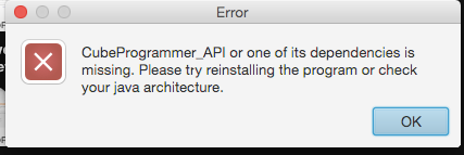

Trying to open the new installed Cube Programming. But Got this Error say missing API or JAVA. I had download everything I can find on JAVA and here. Still no luck.
I am running MAC Yosemite , If anyone here know whats missing,.
2019-05-24 2:12 AM
Hello @Tomdy ,
Can you tell me which openJDK are you using? It is possible to do a trial with java 1.8.0 and tell me the status?

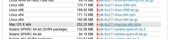

Thanks for the reply. I think I already installed 1.8.0 . Please see the photo I download the SDK here.
2019-05-24 5:20 AM
Hi @Tomdy ,
can you please do "java -version" in your terminal and tell me which version of Java is installed?
