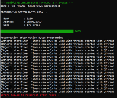

I have tried this on my STM32H5 and there is no error, but it still attempts to reconnect

I have confirmed that it is fixed when programming STM32WBA
However the issue is still present with STM32H5
2026-04-23 9:18 AM
Just to reconfirm, issue is still NOT fixed for STM32H5.
Hope it will be fixed in the next update, as the delay when programming for me is 2x longer than the actual programming.
