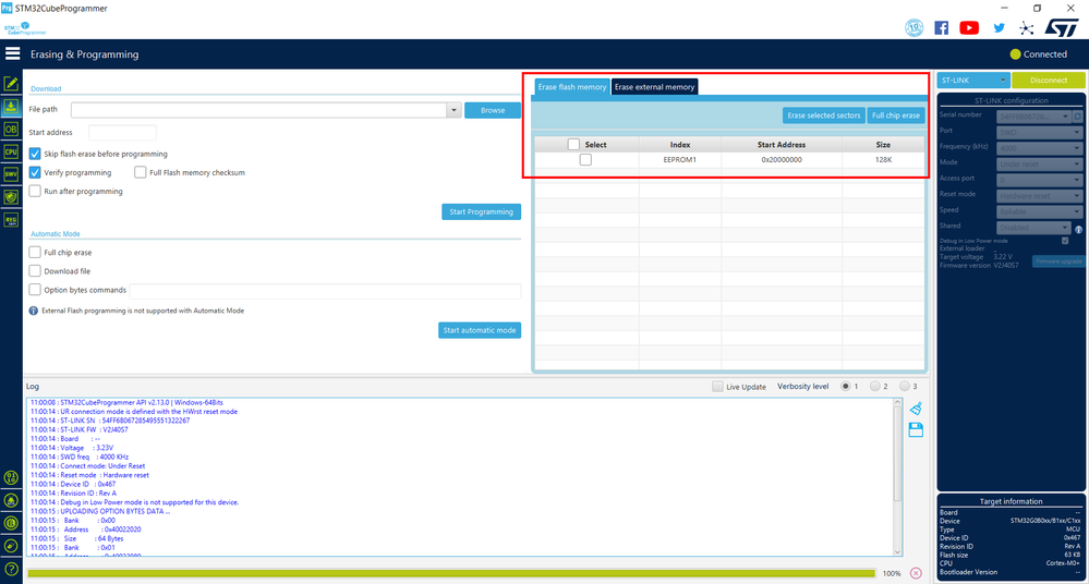

09:28:36:790 : Error: failed to download the FileAs a side note, the attached picture shows the "flash" seen by CubeProgrammer GUI: one block of 128k, seen as EEPROM1, in the RAM area...
Please ST, fix this loader ASAP. I know that the tools are free, but still it should be an easy fix.

2023-05-30 8:50 AM
I am not working on CubeProg, but I experience the issues you describe.
It's look like my flash was corrupt and CubeProg regonize it as an EEPROM at @0x20000000. To solve the issues I try to access the board with the DFU (More infos here) and I could erase the memory (Full Erase). After that I could flash any program without issues.
Hope this could help,
Best Regards,
Axel L.
