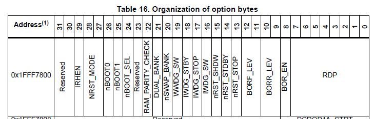

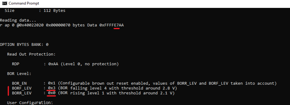

BUG.
STM32CubeProgrammer 2.10.0 (probably older versions too) has an issue with showing correct BORF_LEV and BORR_LEV Option byte values, they are mixed with each other.
Adding screenshot from CLI.
OB data: 0xFFFFE7AA, where E7 in binary 0b1110 0111.
According to the datasheet OB table, the BORR_LEV would be "11" and BORF_LEV - "00".
So, in CubeProgrammer (and CLI) it's swapped.
From STM32G031K6 datasheet:

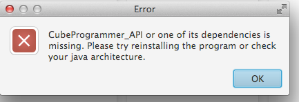

Helo, I got error after installing CubeProgrammer v2.10.0 on os x 10.9.5.
java -version
java version "1.8.0_331"
Java(TM) SE Runtime Environment (build 1.8.0_331-b09)
Java HotSpot(TM) 64-Bit Server VM (build 25.331-b09, mixed mode)
please somebody tell Me how to fix it. Thanks you
