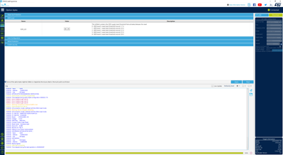

Controller STM32U073, programming with STM32CubeProg v2.17.0 ist the BOR Level in option byte wrong.
Programing the option byte with the framework,  for example generated code with CubeMX works.

This could really be presented better. In what way is it wrong? What steps are you taking and what results are you seeing that are different from what you expect?
STTwo-32
Hello @Pypke
If you are reporting about the fact that the BOR bits on the STM32U0 MCU series is set to 6 on the Factory settings, this issue has been raised to the Dev team for correction (under internal ticket number 189186):
