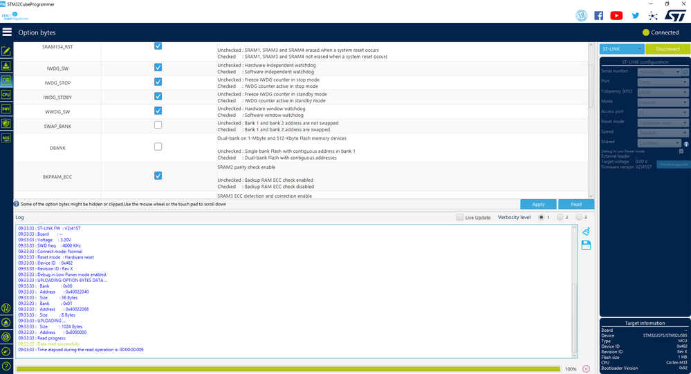

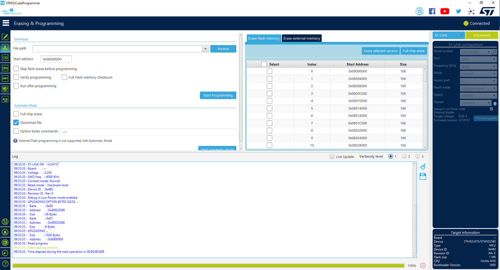

Does anyone are able to erase a memory page of BANK2 on a STM32U575 with ST-LINK/V2 in STM32CubeIDE or STM32CubeProgramer? The mcu is configure in dual bank by default. I'm only able to work with a SEGGER JLINK (in IDE) or it is possible to program mcu after a full chip erase. When I put it in single bank mode, the IDE only erase 8K of the 16K page and generate an error at verification.
Thanks

2023-05-01 6:36 AM - edited 2023-11-20 6:57 AM
Here is a snapshot of the programer.
When I uncheck the DBANK Option like next picture.
