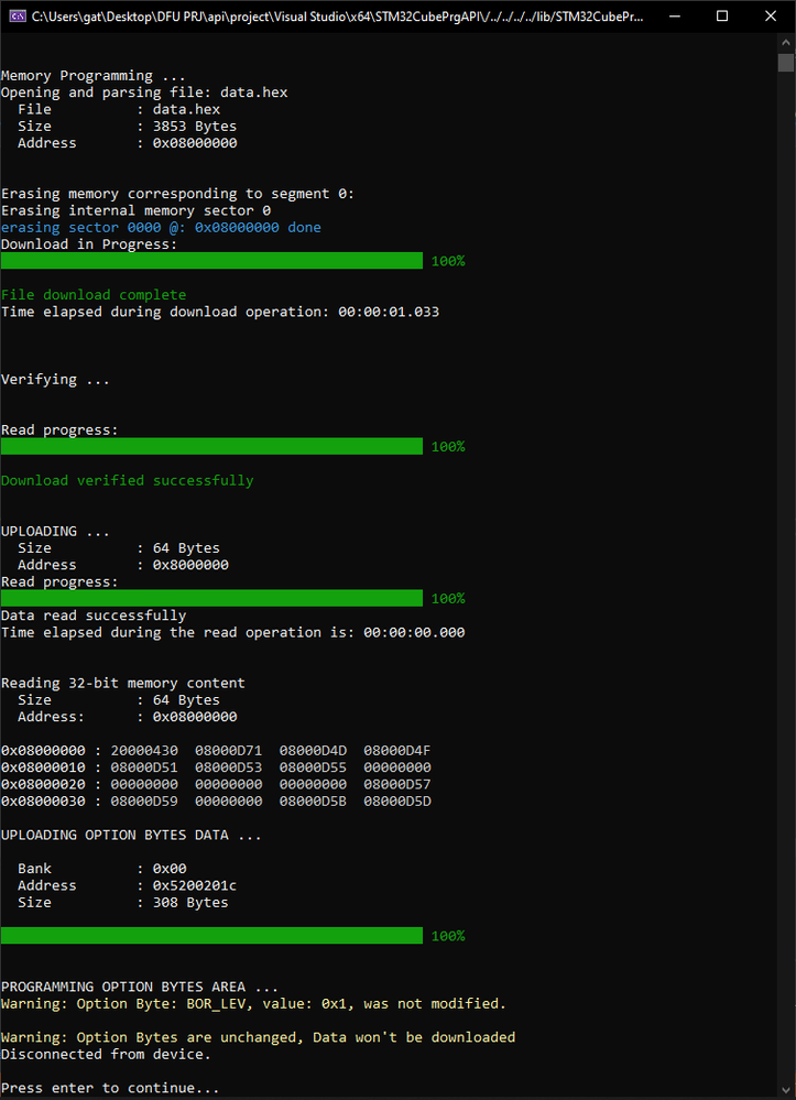

I put my STM32H743XI in Bootloader mode and launch STM32Cube Programmer USB example on VS and got :
I have two question :
Regards

Are you talking about the warning on BOR level not being updated ?
If so, it is not an error and you can skip it if you don't need to program the BOR Level.
