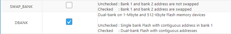

It seems an option byte was somehow switched.
I tried different combinations of SWAP_BANK and DBANK and this is what works for me now.
Hopefully this will help someone with the same problem.
