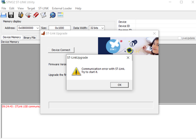

Whe try to connect via ST-Utility:

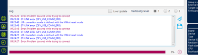

and in STM32Propgramer:
