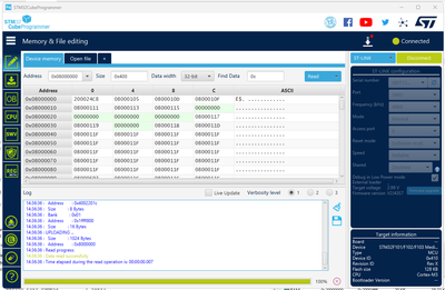

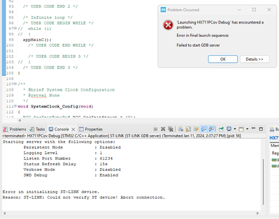

I have several bluepills STM32F103C8T6 that in the STM32Programmer are visible, can connect and read memory. Amyway, when I connect to STM32CubeIDE I get the error "Cound not verify ST device !" or "No STM32 target found!".
Can anyone suggest an issue??

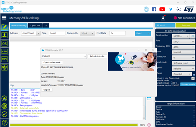

The ST Link V2 FW after update is ... V2J43S7
It can read memory in STM32Programmer
In STM32CubeIDE it does not connects ...

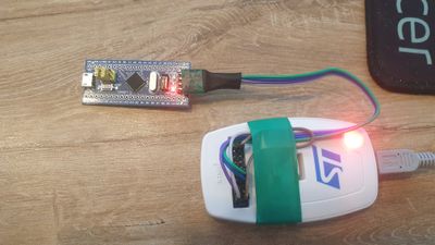

A photo with hardware - all seem original.
2024-01-11 4:55 AM
@CSand You are trying to access a Blue Pill with STM32CubeIDE via what appears to be a genuine ST-LINK/V2. Why would STM32CubeIDE program a fake MCU that it doesn't know?
And in case it's not clear to you, although it has been discussed here many times: there has been no Blue Pill with original STMF103 for years.

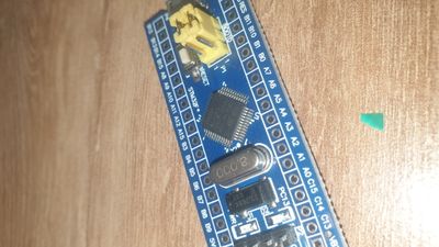

Look on your bluepills : whats exactly written on the chip ? + logo ?
I have some CKS F103 , also GD32F103 - these are good cpus, but NOT by STM !
So IDE now checking: is it by STM ? if not - refuse to work.

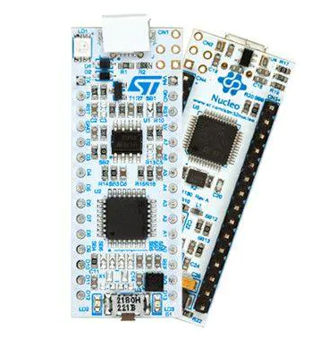

Hi, see nucleo boards at mouser - and price range :
ie if you take a NUCLEO-F103RB , you get even same cpu as on bluepill , + st-link to program, at about $ 11 .
+ can use your old programs without great changes. :)
OR if you prefer similar size as bluepill, take a NUCLEO-F303K8 , about same price.
+ a more powerfull MF4 cpu , stm32F303 ...
