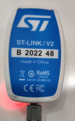

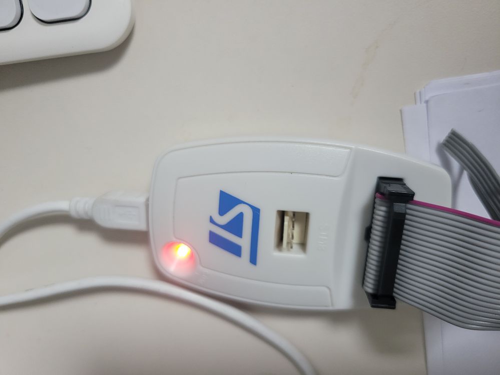

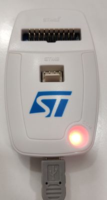

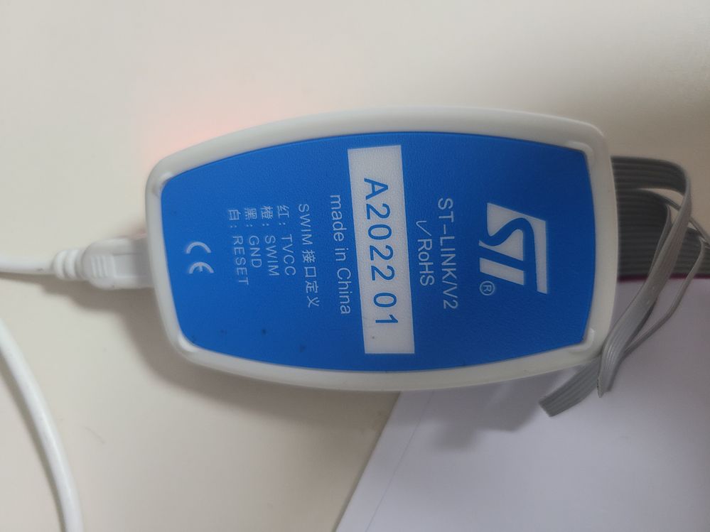

2024-01-02 1:59 AM
Hi Peter
I am facing same issue on 2 ST-Link I bought from Digikey. I can see the serial number on both.
Cube programmer ver: v2.15.0
FW ver: V2J43S7
Below is the image of ST Link.
Please help!
Regards
Goutham
2024-01-02 2:37 AM
@gouku Your ST-LINK/V2 look original and if they are also recognised by the STM32Cubeprog and the firmware can be updated, you can assume that the ST-LINK/V2 are working.
However, you are guaranteed to have a different environment than the TO, so it doesn't say much if you only write that you have the same problems. @MikaelM post also applies to you, so please reply to it.
