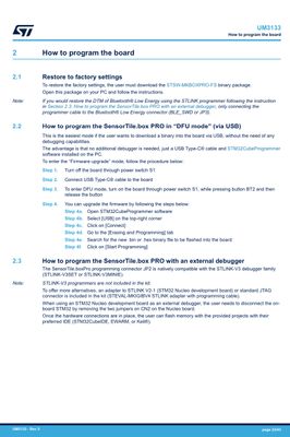

Dear @TJM ,
The procedure is described in Page 22 here
https://www.st.com/resource/en/user_manual/um3133-getting-started-with-sensortilebox-pro-multisensors-and-wireless-connectivity-development-kit-for-any-intelligent-iot-node-stmicroelectronics.pdf
 You need to have ST-LinkV3 which is not included in the Pro Kit . The MCU is U585 .
Hope it helps you
