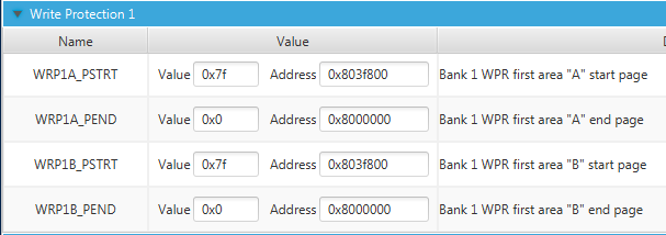

I would like to know how to reset the discovery kit to the default setting?
And how do I know about the current setting (write protection is enabled/disabled)in the discovery kit?
The reason is that,
I suddenly can't run anything on my board(even just an LED toggle), I am confused about what I have done.
The only thing I remember is to set the write protection address by the STM32CubeProgrammer as the photo. Is it caused by this?

From your STM32CubeProgrammer screen shot there is no write protection enabled.

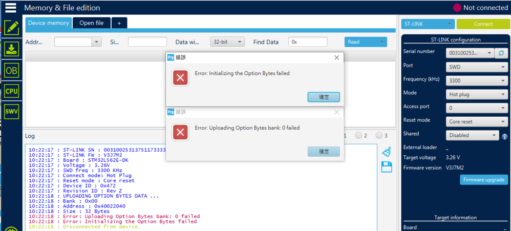

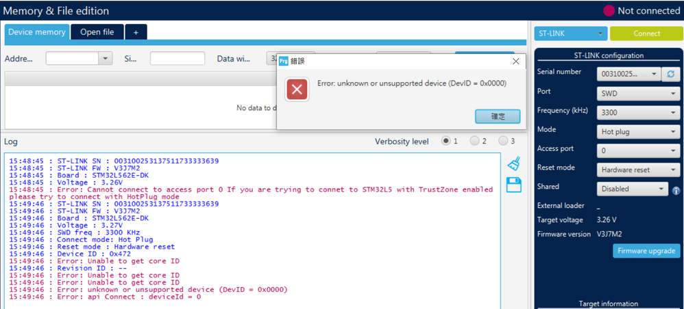

I use STM32L562 discovery kit. Everything going well before I set the option bytes like the previous photo(this is the only thing I remember...). After setting that, even just a very simple code(only toggle LED and printf), consoles says "download successful" but nothing happened, no LED no printf. I think maybe setting some protection so I set RDP to LV1 and try to downgrade to LV0 to erase the flash. And the CubeProgrammer gives me this error:"initializing option bytes failed". I have used to shorted BOOT0 and VDD and press the reset button, the error:"unknown device" is shown. I have no idea what can I do now. May you help me?
