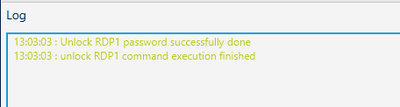

4.2. I have written the OEM1 password and pressed on "unlock RDP" button“

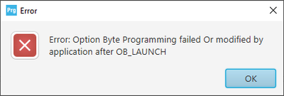

The following status was observed

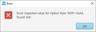

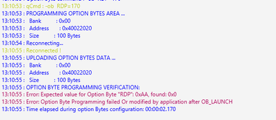

4.3. Changed the Option bytes values [ changed the RDP level to 0], and performed OB write by "apply" button
4.4. The following error was noticed

4) Even if I enter an incorrect OEM1 password, the operation still succeeds, indicating that "Unlock RDP password successfully done." Does it not verify whether the provided password matches or not?
Did you write 0 or 0xAA to it , to set it RDP = 0 ???
Because it complains: option byte now : 0x0 .
2025-10-07 9:09 PM
Written 0xAA, to make the regression

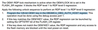

According to the steps mentioned in the section 3.5.1 OEM1 RDP lock mechanism in the CPU user manual,
Eg: OEM 1 regression
To execute this procedure, the OEM key must be written to the DBGMCU_DBG_AUTH_HOST register [also referred to as mail box registers], which can only be done through an external debugger in AP1. Therefore, to carry out the mail box write operation, I have adhered to the following steps:
