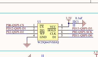

I created an external flash STLDR file for my board, with STM32H750VB chip and W25Q64 QSPI FLASH. After copying the STLDR file to the cubeprographer directory, it can perform normal external flash read/write and sector erase functions. However, when selecting full chip erase, the cubeprographer prompts me "please select external loader before performing external full chip erase". But I am sure that my code contains the correct int MassErase (void) function, and I used the readelf command in Ubuntu environment to read the STLDR file I created, which also includes the MassErase function. But it seems that this function cannot be correctly detected by the cubeprographer. How can I locate the cause and solve this problem?

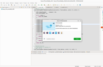

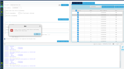

this is my Screen shots and error message

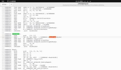

This stldr file can help me perform external flash read, write, and fast erase functions, but full chip erase cannot be used.

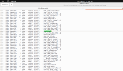

I saved the output of objdump and readelf commands in CMDobjdump.txt and CMDreadlef.txt files. It can be found that the masserase function exists in both files. However, when executing external full chip erase, the error shown in the figure above is always prompted. I put part of these two files here for easy display, as well as my cubeide project. By the way, the cubeide I use is the Linux version, and the development environment is ubuntu22.04.5LTS.
This problem has bothered me for a week
Thank you again for your reply

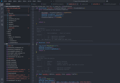

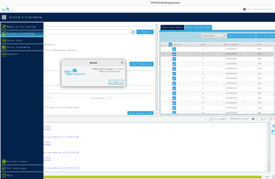

this is source code screen shots
about of the cubeprogrammer

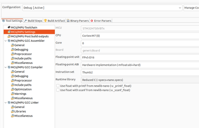

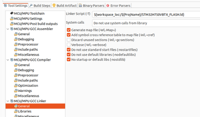

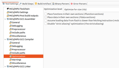

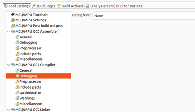

In the Ubuntu CubeIDE environment, I set up the CubeIDE project as follows:
Is it possible that these settings may cause errors?
