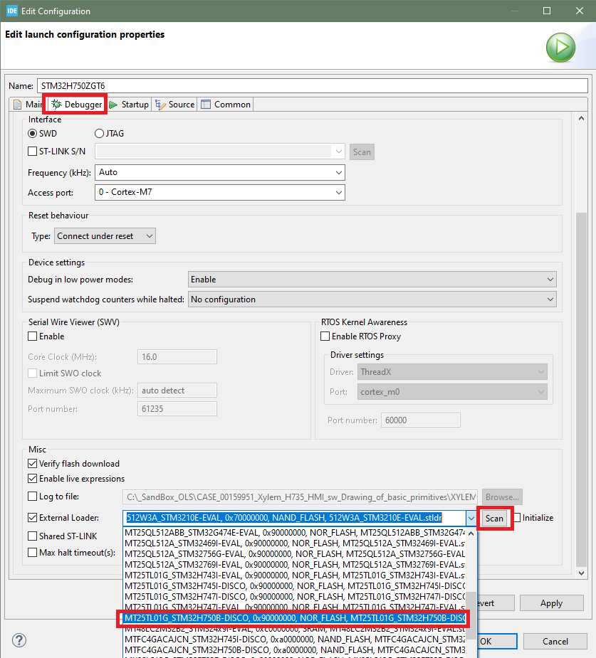

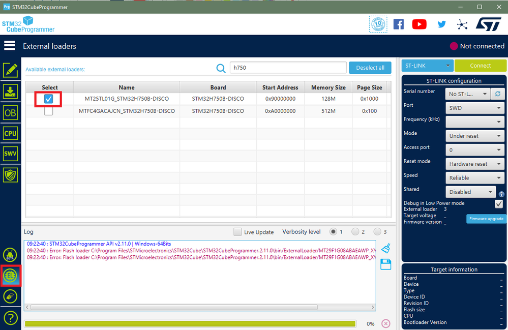

As mentioned in the other thread, the workaround mentioned by @Community member is only relevant for custom external loaders. When using an ST development kit such as the STM32H750B-DK you just need to select the proper external loader in the "EL" tab of the CubeProgrammer :
STM32CubeIDE include its own version of CubeProgrammer so the same applies, open the Debug Configuration, go the the "Debugger" tab, then :
See details in section 3.4.1 (Revision 6) of the STM32CubeIDE user manual
