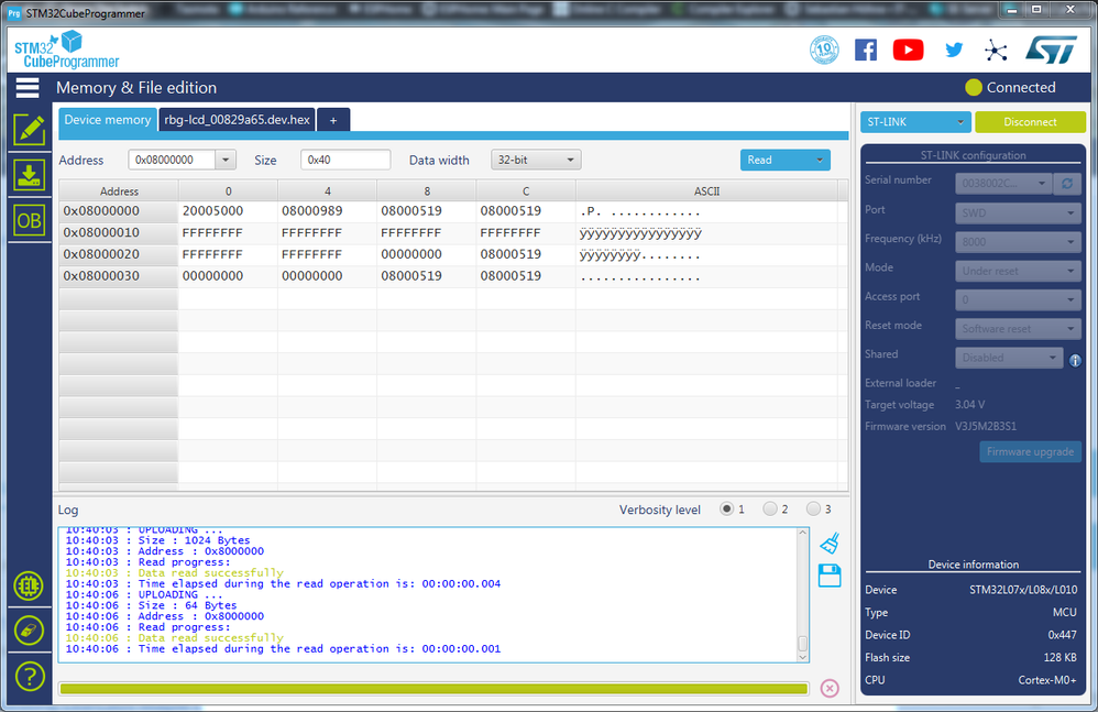

5.) The new hex-file tab shows that the gap from address 0x0800 0010 till 0x0800 0028 will be filled with 0xFF and not with the processor specific "unused/unprogrammed byte" which has to be 0x00.

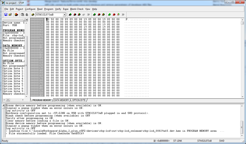

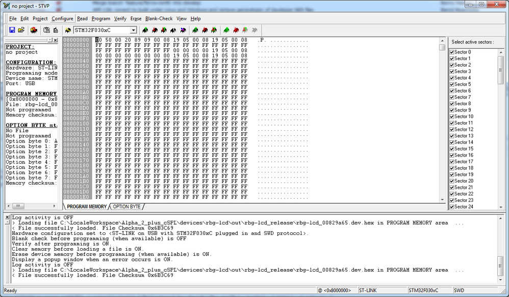

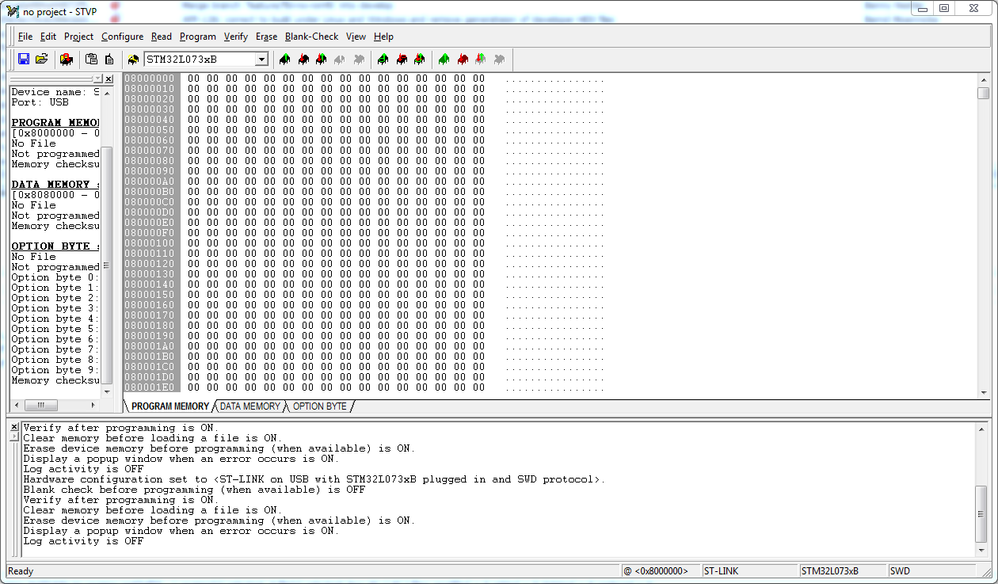

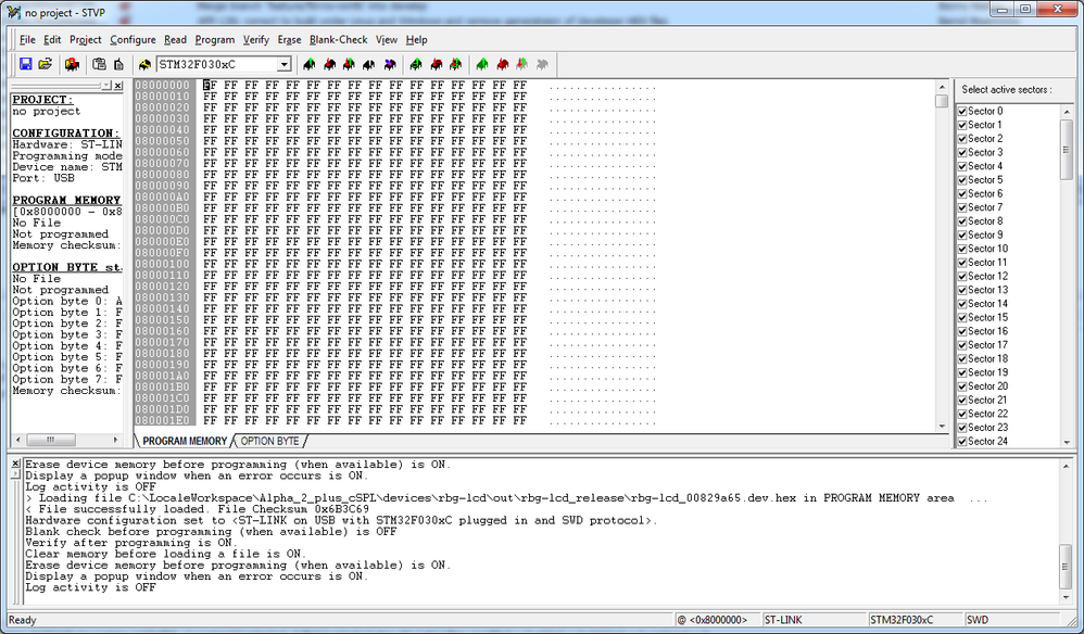

6.) programming the device and read out the first 40 bytes leads to this screen
The gaps from the hex-file are actually filled with 0xFF which is wrong from my point of view.
The old STVP don't fill the address gaps with the wrong initial byte. It fills the gaps with the correct device depending initial flash byte value.
You can see this by loading for example an STM32L0-device, where the initial state of all flash bytes should be 00 or by loading a STM32F0-device, where all bytes have to be 0xFF in the initial state.
STM32L0-device empty
STM32L0-device with loaded hex-snippet
STM32F0-device empty
STM32F0-device with loaded hex-snippet
