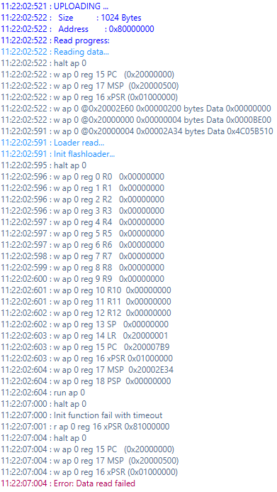

However when I launch my external loader in STM32CubePrg to read my external flash, I fell into a timeout like this :

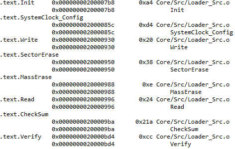

Here are how my Loader_Src functions are mapped in my RAM :
The PC value is my Init address, so I expected it to work but not yet !
I have no idea where the error could be from, maybe the RAM mapping, the linker script..
I could post my Loader_Src file or more details if you need.

Hi @Maël Lair ,
I'm facing exactly the same issue after upgrading from CubeProgrammer v2.4.0, could you find the solution for this?
