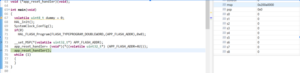

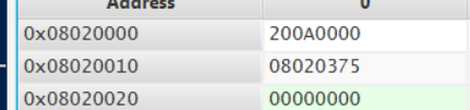

}Same when it's global :
#define APP_FLASH_ADDR 0x08020000
void (*app_reset_handler)(void);
int main(void)
volatile uint8_t dummy = 0;
HAL_Init();
SystemClock_Config();
if(dummy)
HAL_FLASH_Program(FLASH_TYPEPROGRAM_DOUBLEWORD,(APP_FLASH_ADDR),0x0);
__set_MSP(*(volatile uint32_t*) APP_FLASH_ADDR);
app_reset_handler= (void*)(*((volatile uint32_t*) (APP_FLASH_ADDR+4U)));
app_reset_handler();
while (1)
}If HAL_FLASH_Program is taken into account by the compiler, the jump doesn't occur anymore. It's very strange to me because in both case of the condition (dummy = 0 or just 0) the main stack pointer is properly set at the right adress :
