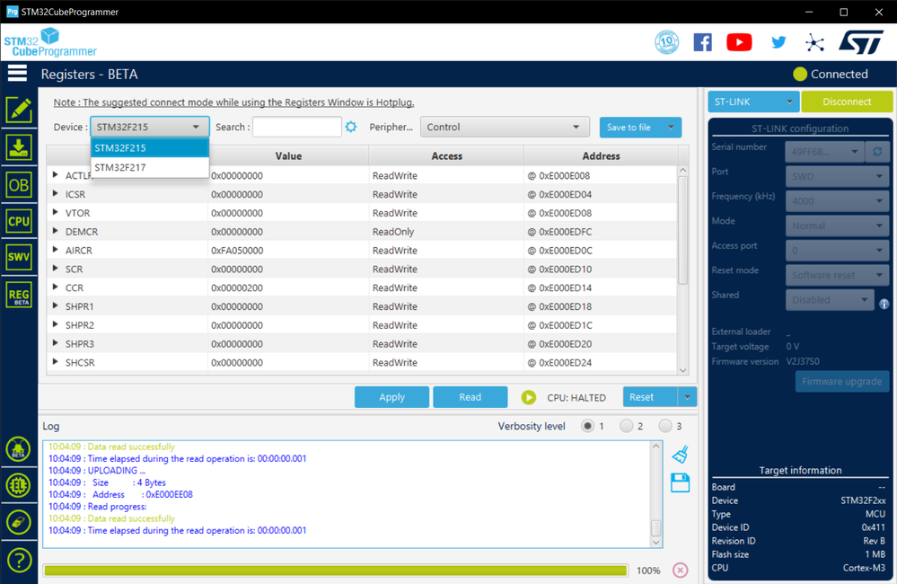

The MCU on my STM32F407-DISCO1 board is being misidentified as STM32F215 / 217.
I'm pretty sure it is in fact STM32F407VG. What could be causing it?

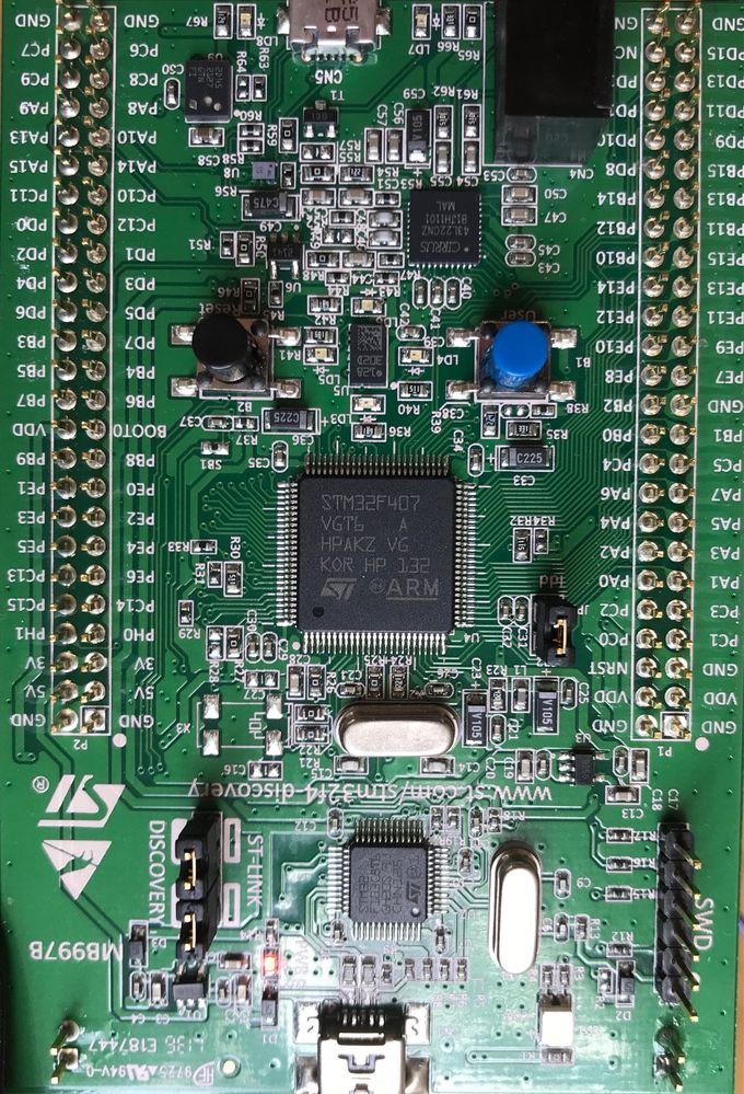

I think it's an early part circa 2011, seen as a STM32F457, and perhaps needs special casing
https://community.arm.com/developer/tools-software/tools/f/keil-forum/35983/scary-stm32f4-compiler-issue
On a DISCO (Rev B) not DISC1 board

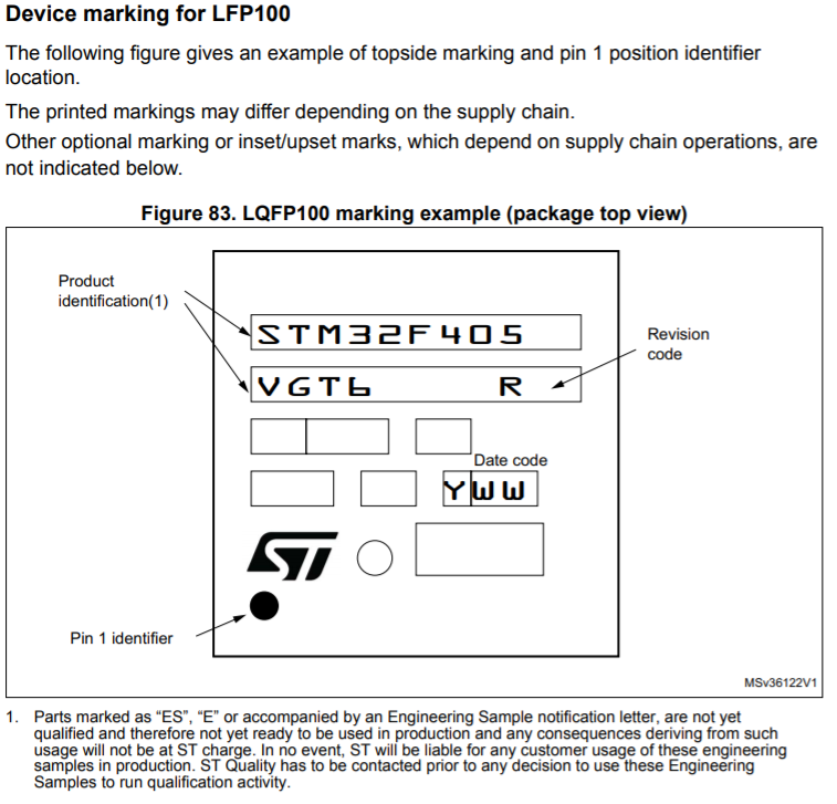

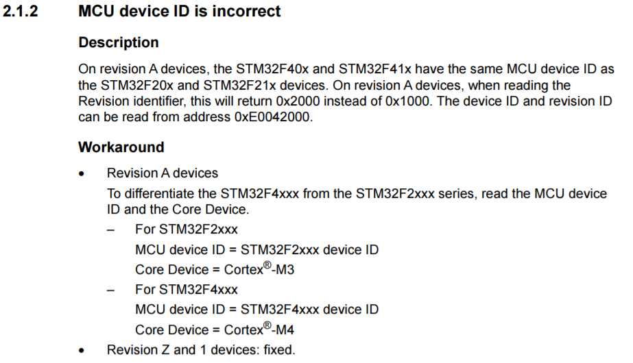

Not sure about it being STM32F457, but it does seem like the chip is Rev A and the board is Rev B-00.
Yep, confirmed in the errata sheet.
