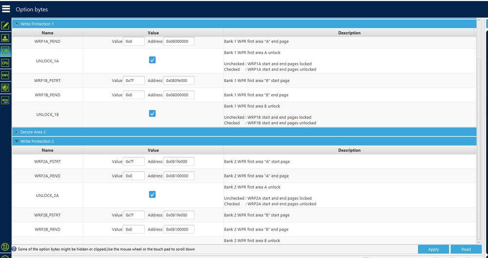

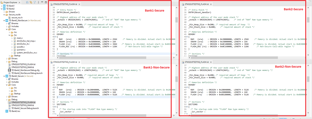

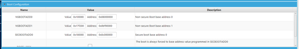

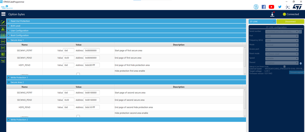

Here I have attached flash ld. file for all four hex file. and option byte configuration.
I want to switch between two firmware which are located in bank1 and bank2 in trust zone.

Linker file should not get changed from Flash bank 1 to bank2.
