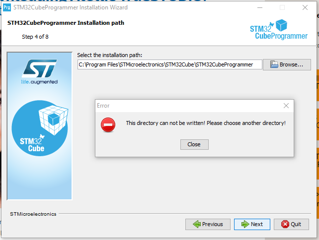

I am brand new to STM, and I'm trying to install the STMCubeProgrammer, but I keep getting the same error message when I'm attempting to select my installation.
I've tried making a different file path by hand, which didn't work. I tried going back to version 2.2, and that didn't work.
I'm attaching a picture of the error window. Any help would be greatly appreciated, so I can start learning how to develop with this board.

Run as Administrator for the installer. Watch also for interference from AV software, or IT policies.

I have this exact same problem installing STM32CubePrg-W64 2.14.0 on PC.. I have full admin rights. I get the same result on two different PCs.. where could this be going wrong?

Please tell us a bit more about your PC. Windows version? Language? Is any antivirus, "endpoint protection" etc. installed? This is a technical forum and we need relevant details.
2023-09-13 6:52 AM
Potentially Disc Full, Directory Attributes or AV or similar standing in the way.
Would suggest a different directory off root, or a different drive. A real directory rather than a per user virtualized one.

Installed STM32 Cube Programmer v2.14.00 to a Win10 Laptop this morning. So download and app work on this 64-bit Intel device.
