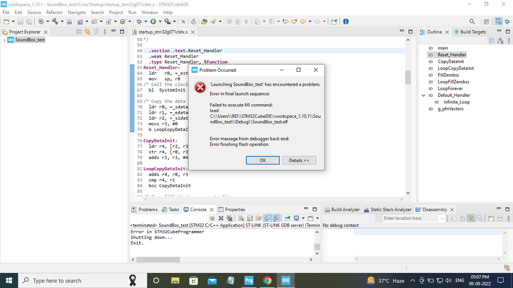

@Community member​ and @MM..1​ I have attached the image of the dialogue box showing the error. Again I have tried but the same error occurred. Please help me.0693W00000Sv3uSQAR.png
Still hard to help, maybe incomplete debug configuration, maybe long project path or folder names with spaces or special chars usw.

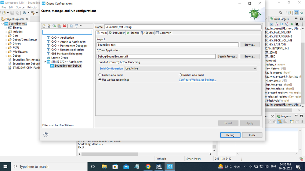

Try show screen debug config , on your shot i see used \\ \\ path , from where is your project git? On example
SGoel.2
Associate III

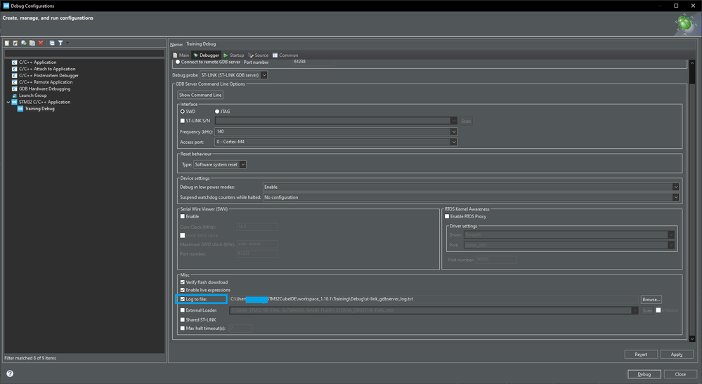

Also I want to ask you to post the rest of the debug configuration and try to generate and send post the debug log so I can analyze it.
You can do that by checking the box "log to file" under the debugger configuration window.
