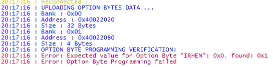

2020-04-19 1:17 PM
Identify the device is bellow:
If I want to write something, it will appear:
There's no capacitor on pine NRST.
On NRST is high level 3,3V, but there were short impulses at 0V. They weren't there before.
IRHEN Checked: Internal resets drives NRST pin low until it is seen as low level.
Can the processor generate an internal reset for some reason?
Unfortunately, you can neither preprogram nor erase the program memory.

2020-04-20 1:18 AM
First: According to the first screenshot, your programmer can't tell the difference between G070 and G071 either ..
Second: If you see *regular* pulses on NRST this might indicate you've accidentally activated automatic start of one of the watchdogs.
These settings are in the very same option word ...
If yes, it might be a bit tricky to get access again: The programmer/debugger must assert NRST and keep it asserted, set DBG_IWDG_STOP and DBG_WWDG_STOP in DBG_APB_FZ1 register while in reset, halt the core immediately when releasing reset and reprogram the
option bits without core intervention. Don't know whether that's available in STM32CubeProgrammer, probably yes, but how to do this I don't know.
