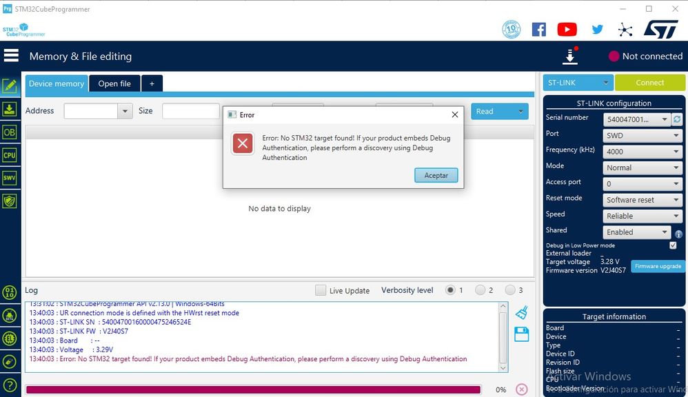

2025-02-16 2:23 AM
I have the same error: "Error: No STM32 target found! If your product embeds Debug Authentication, please perform a discovery using Debug Authentication"
I did a manual connect (wire) with ST and ST link, and there was no change.
could you guide me?

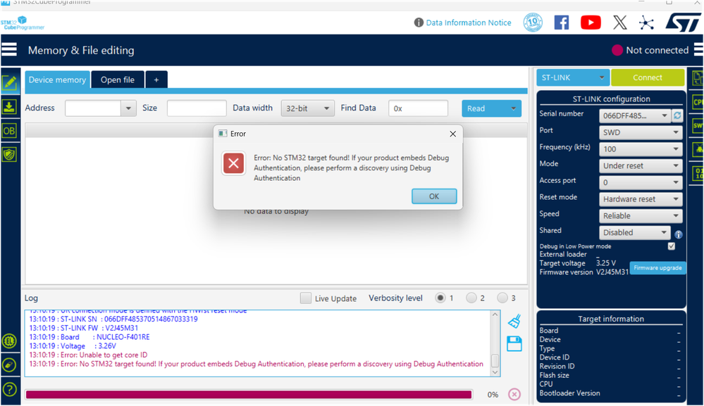

2025-02-16 3:11 AM
I used these methods:
-manual connect (wire) with ST and ST link, and there was no change.
- used STM32CubeProgrammer, where I uploaded the error you can see.
- I joined together BOOT0 and VDD pins.
2025-02-16 6:42 AM
Perhaps start by describing YOUR hardware and what's wired to what.
If using a NUCLEO to connect to external board disconnect SWD jumpers to the local target.
