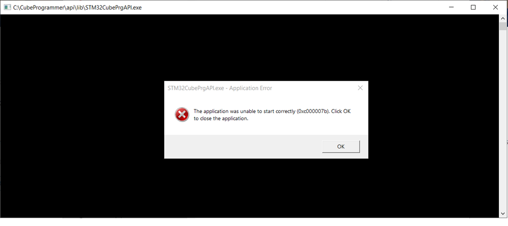

I have the same problem. Always receiving the error 0xC000007B, when is running compiled STM32CubePrgAPI.exe (From STM32CubeProgrammer v2.1.0 package). Compiled binary from the STM32CubeProgrammer v2.0.0 v2.1.0, which is a part of STM32 Cube IDE is running without problems.
OS is Windows 10 x64.
I hope someone from ST will help us to resolve the problem.

Hi, I though, that it was version 2.0.0. But it was 2.1.0 too. DLL libraries are different. Try to install STM32Cube IDE (1.0.1 or 1.0.2 also works for me). From the installation folder, from ./plugins/com.st.stm32cube.ide.mcu.externaltools.cubeprogrammer.win32XXXXXX... copy the content to some other folder and try to compile in QT..
P.S. I didn't see 32-bit version of these libraries.
