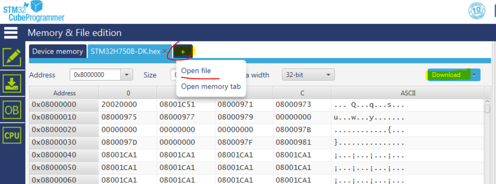

Workaround question: is it possible to use the STMCubeIDE program from the microcontroller from a hexadecimal file? If yes, how?

STM32CubeProgrammer has the possibility to download .hex files by adding them as follow:
I hope this help!
