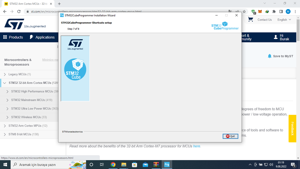

2021-03-21 4:11 AM
when i create this program everything is ok until step7. however i cant pass step 7
and window is below.
2022-05-05 2:32 PM
enabling shortcuts is in step 7 which is shown empty as others have posted. In step 6 the files and drivers are downloaded after the download, I press next and an empty page with only one option "quit" is shown (It is same as the others have posted the screen shot of).
2022-08-08 3:33 PM
operating system: windows 10 pro x64
I'm trying to install cubeprogrammer v2.11.0
Can't get past the screen above.
I formatted the computer and it still didn't work.
I tried all of the above answers and it still didn't work.
(the answers above don't work.)

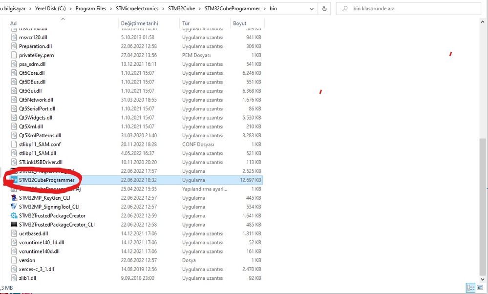

2022-11-20 7:51 AM
I had the same issue as Gdönm.1 and i was surfing at the stmcubeprogrammer files and i've found this so i clicked and it worked ! Maybe this could work for you too.
2024-03-28 12:24 AM
Thank you very much, this is the solution, I registered on that forum to say this :D
