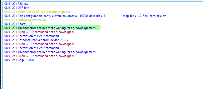

I want to load program with system bootloader over TCP/UDP, I have some problems. My system is slow but working correctly. I tested with direct UART connect there is no error. But I tested over TCP there is timeout error.
How can I increase the acknowledgement wait time?

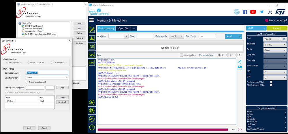

TCP to UART; NetBurner Virtual Comm Port Ver 2.4
My set up;
