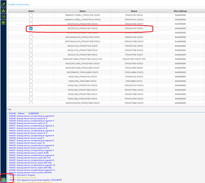

Did you enable the flash loader of the external QSPI memory before uploading the hex file??
The part of the graphics in that demo is located in the external memory (QSPI).

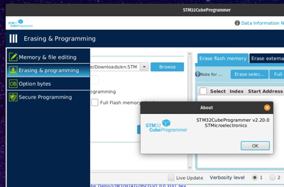

Thank you for your quick response.
I am using the v2.20.0 version of the STM32CubeProgrammer.  I have attached as a screen shot.  I have also attached the log file where I attempted to program the board twice.
I am using the Demo Hex file from ST Micro for this board.
Thank you that solved the problem.  Were you able to discover the issue from the log file?
Thanks,
The log file at level 0 doesn't show much information but I had the doubt you didn't enable the external flash loader. So I tried to reproduce the behavior without enabling the flash loader and had almost the same log.
If you increase the verbosity level in the CubeProgrammer to 2 or 3 you can see there is an issue while programming at the address 0x90000000:
