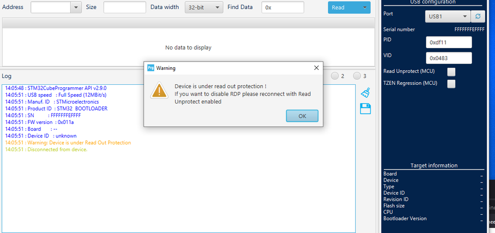

Getting "Device is under read out protection!" error when trying to program STM32F070RBT6 using USB port, Only on certain PCs
AAlla.1
Associate II
When trying to connect:
0693W00000Kb1R2QAJ.pngWhen trying the same thing on a different PC (works on 3 different PCs, doesn't work on 3 other PCs). with the same IC it connects and programs with no issues.
I checked the SW version of Cube programmer, on the 3 PCs that it worked they had versions v2.2.0, v2.6.0 and v2.9.0. The PCs that did not work all had versions v2.9.0.

0693W00000Kb1TnQAJ.pngI am not sure what else could be different between the different PCs that could be causing such an error, any help would be appreciated.

One more thing, Once the IC is programmed Serial communication thru Tera term is possible accross all PCs, but still unable to connect to STM Cube programmer on certain PCs
