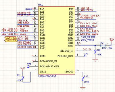

I have attached the schematic,
This is using stlink to flash my hex file to stm32f412, PA13-SWDIO and PA14-SWCLK

Here i have attached my schematic
I have removed green and blue LED's which are connected to PA10 and PA9 pins, and connected those pins to Tx and Rx of usb-to-uart adapter.
2024-10-10 2:15 AM - edited 2024-10-10 2:17 AM
That's not a complete schematic - it's just the STM32 and a load of signal names.
You need to show the schematic - how everything is connected.
@Vaishnavi wrote:I have removed green and blue LED's which are connected to PA10 and PA9 pins, and connected those pins to Tx and Rx of usb-to-uart adapter.
Show the actual schematic as it now stands.
2024-10-10 2:15 AM
Show POWER SUPPLY connections.
Answer VCAP question. Double check placed components.
2024-10-10 2:21 AM - edited 2024-10-10 3:01 AM
The important thing here is the power supply part of the MCU.
For help efficiency and to avoid unnecessary ping pongs, please share all the schematics you have.
Thank you for your understanding.
2024-10-13 10:55 PM
Hello @mƎALLEm
As I shared in previous schematic, UART1 pins are connected to GPS(PA15 and PB3) will it make any difference?
Power supply, I have connected external supply to board i.e., 5v
I couldn't able to flash through PA9 and PA10 pins
While reading in serial debugger I'm receiving FF continuously.
