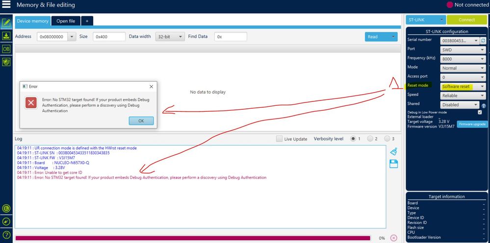

After that, I used the smt32cubeprogrammer tool and configuration for ST-Link as the second photo (Reset mode: Software reset), I received the error:
04:10:41 : Error: Unable to get core ID
04:10:41 : Error: No STM32 target found! If your product embeds Debug Authentication, please perform a discovery using Debug Authentication

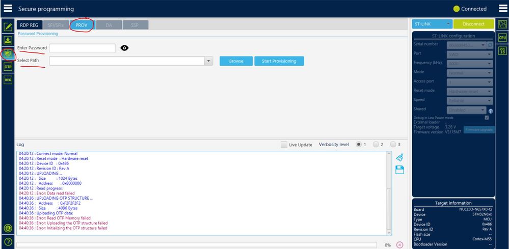

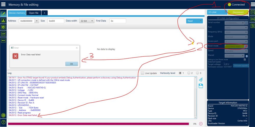

When I changed the reset mode to: Hardware reset, I received an error as Third photos:
04:20:12 : Error: Data read failed
In this case, I saw the tools can read the board stm32N657X0-Q, but it cannot access the memory.

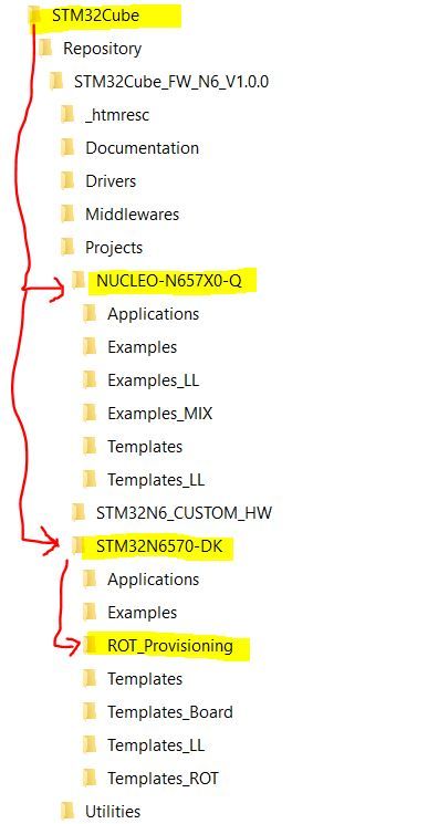

The available guides are related to the STM32H5, H7 series, and STM32N657-DK, but I could not find any documents or guides for debug authentication on the STM32N657X0-Q.
Additionally, as shown in the fourth photo, I searched my local PC for the STM32CUBE initialization. For the "STM32N6570-DK" board, I found a folder named "ROT_Provisioning" that allows key generation. However, this folder is not available for the "NUCLEO-N657X0-Q" board.
