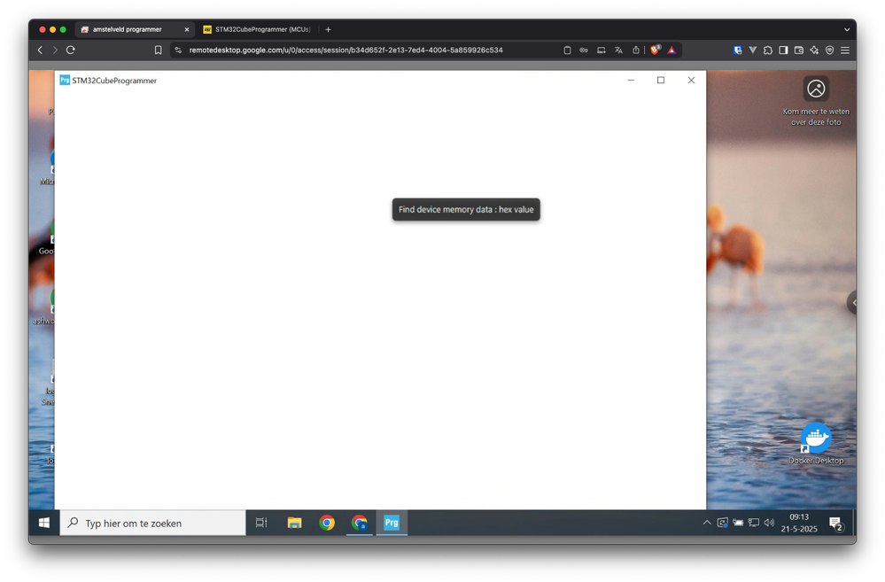

I have just downloaded the latest version but when I start CubeProgrammer, the window doesn't contain anything...
The TrustedPackageCreator application which also came with the installer, does however seem to be working normally.
(I am using Chrome Remote Desktop because this is on a remote PC)

Issue is fixed by adding -Djna.nosys=true in the newline in C:\Program Files\STMicroelectronics\STM32Cube\STM32CubeProgrammer\bin\STM32CubeProgrammer.l4j.ini
I tried this, didn't work. Next ill try updating/removing JDE
