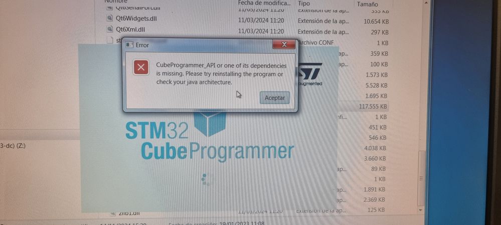

I have installed and working Cube programmer v2.13 in a Windows 7 32bits machine. Today, I tried to update it but it threw an error:
I tried reinstalling and have the same results. I also tried older versions and the last one that works for me was the v2.15. I update java as well but nothing changes.
This means that newer versions will not work on Windows 7 32bits machines?

Hello @Rafa096 ,
Windows 7 is no longer supported by STM32CubeProgrammer since v2.16.0 due to the migration to QT6. For detailed information, please refer to section 1.1 System requirements in the UM2237 document, which outlines the supported operating systems and architectures.
Maryem.
