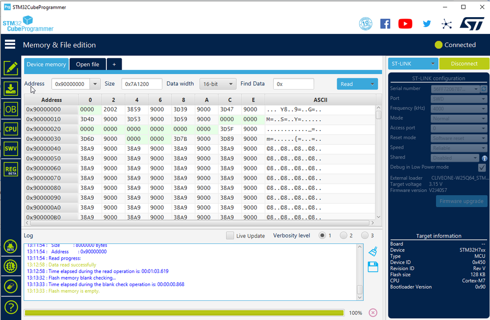

How to erase external Flash? It does not work with Cube-Programmer, or it does not look empty...

2023-03-07 4:21 AM
You'd need to click READ button again, perhaps with less length to reduce time, as this won't auto-refresh.
A mismatch suggests the write or prior erase failed. At a bit level perhaps bus integrity or timing.

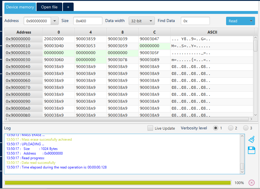

2023-03-07 4:51 AM
I get the message that erase was successful, but it does not look empty, why this, see image below?

2023-03-07 5:31 AM
The erase pattern for flash is typically 0xFF, not zero

>>It looks read works but not write
If you re-read the data after the Erase, then it's looking like the erase is failing or ending early.
If you've used Micron or Macronix loaders or BSP on these, it's possible that blocks may be protected or locked, such that the erase/write fail on them.

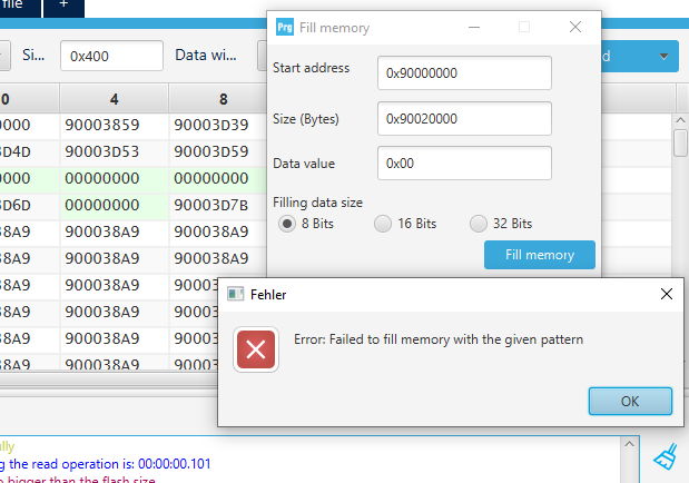

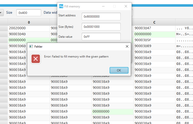

I click full chip erase at external flash and I don't get any error message, but memory still looks not empty. I also cannot fill anything...
